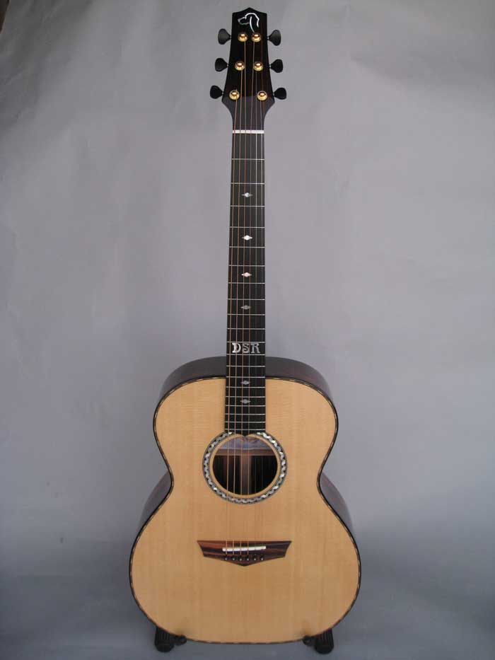

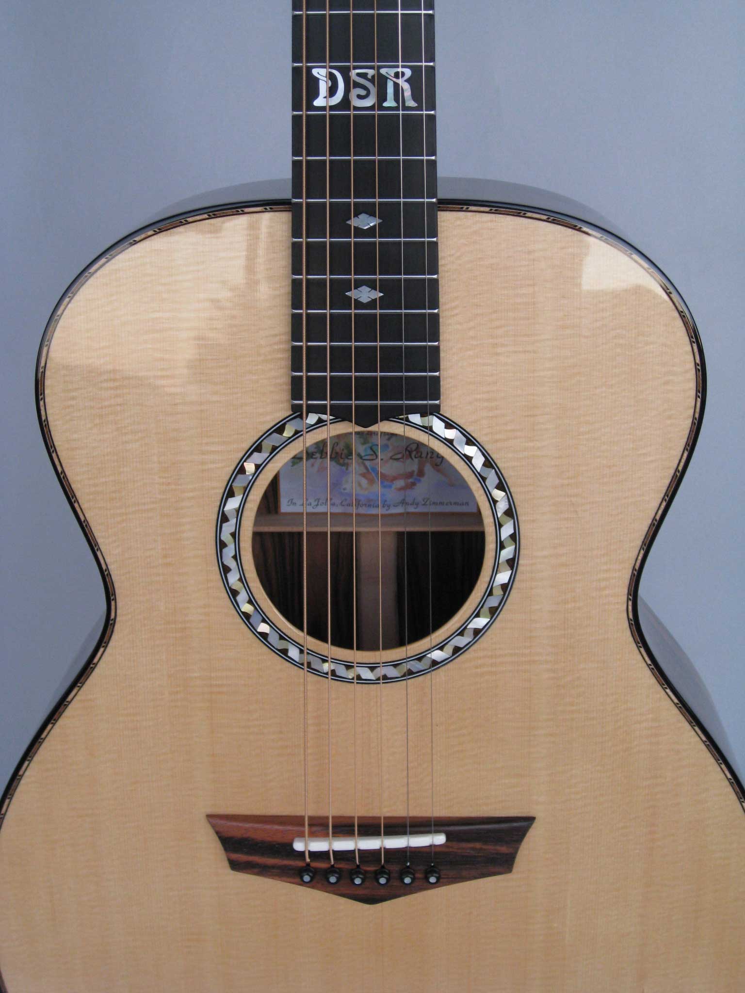

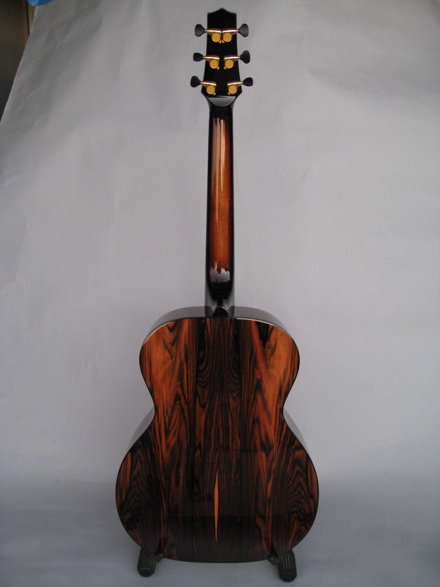

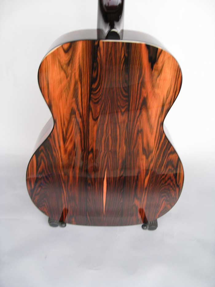

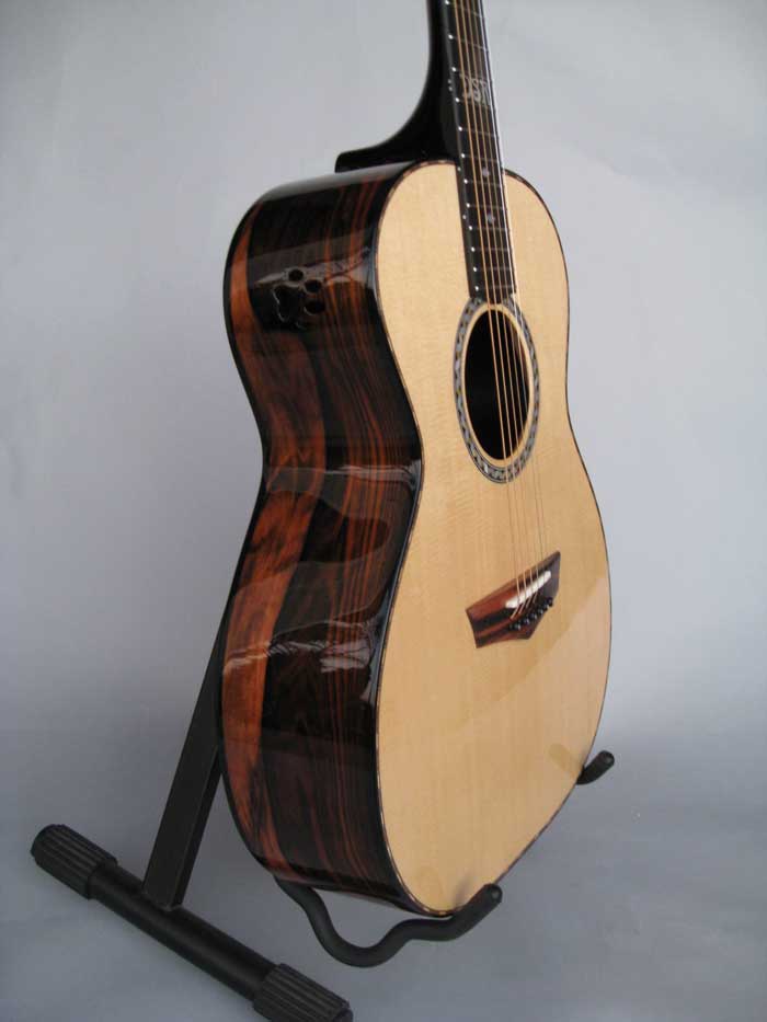

Hi
Here is another just completed. I think it was a suceess because the customer cried!!!! Happily so.
The specs are
000 24.9
Malaysian ebony from the Zootman
Lutz Spruce - Shanes
gold and white MOP inlays from Andy DePaule
Tony's Urethane
Thanks for looking

Very nice Andy!
I really like the letters on the neck. That font or style is nice!

PostPosted: Wed Oct 31, 2007 2:10 am
I'm with Waddy...I think I shed a tear or two just looking at that. Incredible.
Say, what's the deal on the saddle? It looks sort of scalloped. It's beautiful, and classy looking, but could you say a few words about what you're doing that for? Thanks.

that is so sweet,
the ebony is what it is all about,
Is the back 2,3 or 4 piece? The figure is so coolClap

Andy,
Very nice. I like the purfling.
PostPosted: Wed Oct 31, 2007 2:32 am
Classy all the way. Love the finish treatment on the neck. I bet Debbie will love this for a long time!!!

Thanks All
I forgot...After making a nice prototype saddle John Watkins made a bunch of them for me. This is an example of his very fine work!!!!!!!!!
As far as the saddle goes, it is not scalloped. I use a 3/16th wide saddle for more room for intonation and the ability to have a nice gentle curved slope off the back towards the bridge pins.
It is a 2 piece back

PostPosted: Wed Oct 31, 2007 7:06 am
Joined: Thu Sep 20, 2007 4:22 am
Posts: 12
The burst on the neck makes me wanna cry - freakin' awesome!

beautiful Andy!!
How did you inlay the rosette?
the pearl first in its own slot -or everything all at the same time?
nice art!
mike

PostPosted: Wed Oct 31, 2007 8:09 am
I route a channel wide enough for all the purfling and the shell in the rosette. Then I glue the BWB to the inside and outside of the channel with CA. This leaves a channel for the pearl. The pearl is then placed carefully and a tiny amount of thin CA is used to hold the many pieces in place.
Finally I use colored epoxy (This one is colored with a brass metallic powder) to fill in the space around the pearl inside of the BWB purfling. Once cured and run the top through my thickness sander to level off. You have to be careful not to go to far or the gold MOP will no longer be gold
PostPosted: Wed Oct 31, 2007 8:16 am
Posts: 1271
Nice....
I like the peaghead, fingerboard end, bridge shape mirroring.

PostPosted: Wed Oct 31, 2007 8:23 am
Don't you just love the Mal. Ebony under finish
SWEEEEEEEET!!!!!!!!!!!!!

PostPosted: Wed Oct 31, 2007 8:32 am
Posts: 565
Andy that is a beautiful guitar.   The neck shading is perfect, matches the colors in the body.
PostPosted: Wed Oct 31, 2007 8:35 am
Andy that is a real beauty. That ebony looks great under finish as does that gorgeous top. Mind if I snag a few of those pic's?
